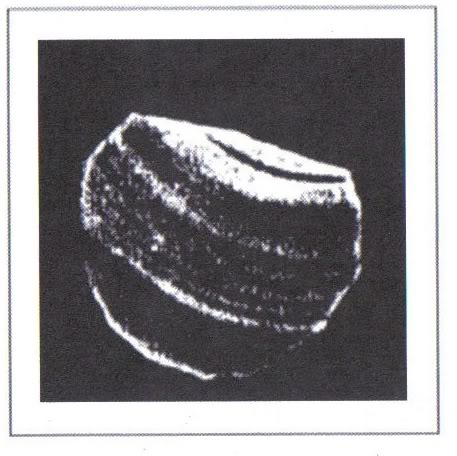

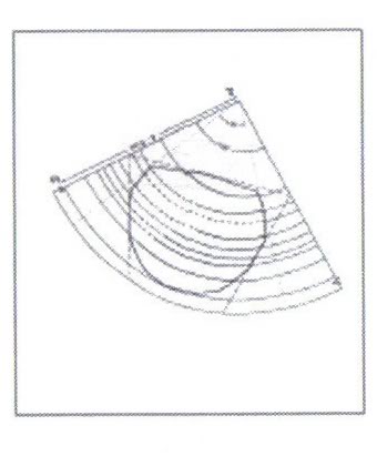

Die stammt von MIR. Ich habe die Maße und den Radioscan vom Bogen. Im Nachbau bei 181cm Länge und 37x31mm im Griffbereich kommt ein ELB-ähnlicher Bogen aus guter Eibe auf +120#@31"
Interessant ist, dass der Bogen nach heutigem Standart 'falsch' herum im Holz liegt und ein reiner Kernholzbogen ist.
Mark Stretton und Joseph Gibbs konnten den Bogen begutachten und folgerten:
Otzi's bow is a finished bow in every respect, the story of it being a bow blank is rediculous, i have spent a lot of time looking at this bow in the museum in Bolzano with Mark Stretton and Joseph Gibbs, this bow is perfect, the reason people believe this bow is unfinished is due to the fact that when put on Dr Kooi's computer model alongside a similar MR bow the computer came back with a possible draw weight of 165lb, and the academics doing the original study found that this draw weight would not be possible for this little man to shoot. Also answer me this, Otzi is wandering around the mountains with a quiver of 6 arrows, a 6'10" string at the bottom of the quiver and a"6' LONG UNFINISHED BOW", i don't think so. Also if you look carefully at this bow the tooling marks have been made by a tool that is much smaller than anything Otzi was carrying, I do not believe that he made this bow himself.
It is definately inside out, i have the "Cat Scans" of the cross section and the back of the bow has no sap wood and is from the centre of the tree, in fact it is all heart wood., You obviously from your innacurate statements have never seen or examined this bow, you also have no idea of the properties of High Altitude Italian Yew.

Nicht wirklich, denn der Radioscan zeigt eindeutig die Lage der Ringe.Yumiya hat geschrieben: Könnte das die Antwort darauf sein?
Yumiya
Re: Fragen zum Zuggewicht verschiedener Jagdbogen - bitte he
Blacksmith77 "Nicht wirklich, denn der Radioscan zeigt eindeutig die Lage der Ringe."
Ist richtig, was der Radioscan zeigt, lediglich die Interpretation wo Bauch und Rücken ist läßt das Bild offen. Und demnach kannst Du es so sehen oder so.
Ich wär bei dem Bild garnicht auf die Idee gekommen, dass der Bogen "verkehrt" rum drinliegt.
Wenn Du allerdings das Profil des engl. Langbogens zugrundelegst hast Du recht.

@laurin
Mag sein, dass der Bogen einen runden Rücken und einen flachen Bauch hatte und somit wieder 'richtigrum' läge.
Das tut aber der Sache keinen Abbruch, dass eine gute Eibe nach den original Ötzi-Maßen gebaut problemlos über 120# auf 30" Auszug bringt.
Das ist einfach so.
