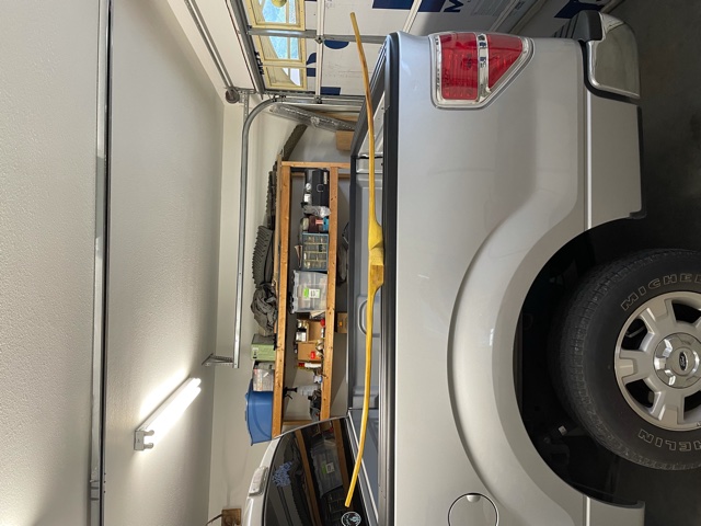

Here it is complete. Ready for the woods.
HH~
