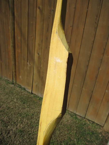

Started on a 26yr old piece of Osage. Should make a really nice 68" bow. Wood is very springy. Had to build up in grip area. has a natural sight window for a right hand shooter. Wood is very springy.
Hedge~

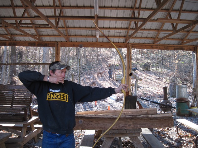

Do you floortiller? I would prefer the limbs to bend more evenly before stringing and tillering. But i work with whitewoods mostly and so i try to narrow down the time when the forces are spread unevenly on the wood. Maybe Osage is not that sensitive in that matter?
HedgeHunter
Beiträge: 87
Registriert: 19.07.2021, 15:35
Re: The Hedge is here
Beitrag von HedgeHunter »
Like to get a string on early. Yes, you must floor tiller so you don't have a very uneven first brace. By getting a string on it early with a lot of weight it lets the Osage feel that. Much easier to hit your target pull weight. The bow is reflexed near the tips, what your seeing here is the uneveness of that reflex affecting the profile some what. This is a low brace only 4.5" or so.
In this photo you can see inner third is bending some but mid and outer limb not as much. Will be relatively easy to bring into good tiller without missing bow weight this way.
This is a character bow as it has plenty pin knots and limbs were vertically and horizontally wavy. Had to be flattened then moved left and right. Has ten heat treatments on form to this point. Was worth it for a 26yr old stave of Osage.
HH~
