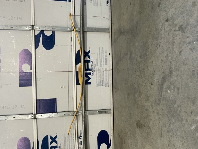

Have the bow out of form now and almost ready to tiller. Floor tiller is complete. Will put tip overlays on it to start the formal tiller process. Looking OK for now. Should make a nice shooter with a shelf so arrow can sit on it while hanging up.
Hedge~

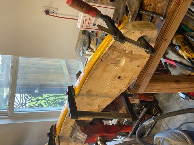

Got tips on bow and have some heat alignment to do as the string is favoring the off shelf side. Should not be very difficult to align the limbs with some heat on the form. then on with finishing tiller. Floor tiller is complete as well. it is 65 inches from sting grooves and 67" overall length.
HH~

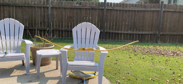

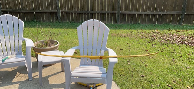

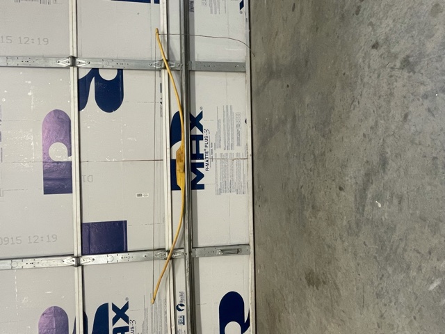

First brace after floor tiller. Still heavy. In no hurry as I have working in forest now.
HH~

Bow is out to 20" now and 44lbs.
HH~

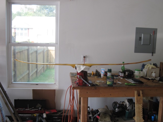

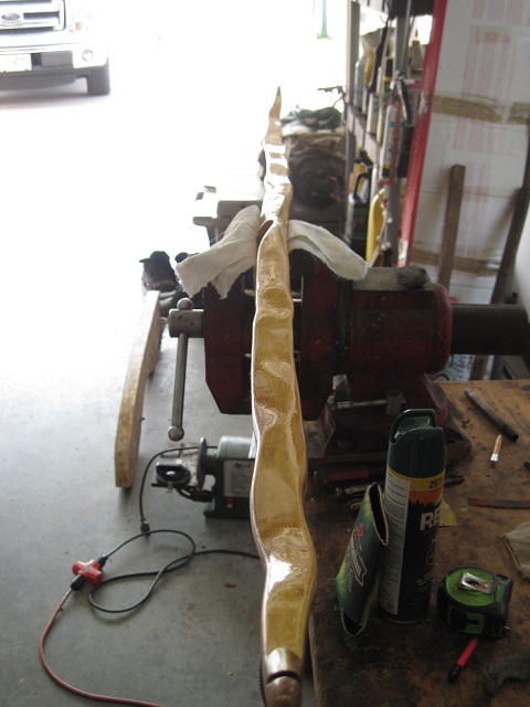

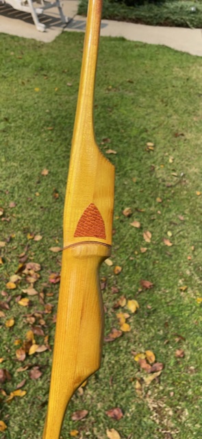

Here it is complete. Ready for the woods.
HH~

Aye,man,quite good looking Bow you made :D
Won't go to more draweight? 45# is ,maybe, not enough for you,i assume. I'm going to my 6ties,and so is my draweight,about 60#+. ;)
As you are ,maybe,much younger than me, I'd like to see some Bows of yours exceeding the "Common Comfort Zone". ;D

Im about sixty. The man who wanted a bow had picked the weight he wanted not myself. Heavy bows are easier to build to me. Very easy to build 60-70lb Osage bows, not nearly as hard as building a very good performing 25lb Osage Bow.
I have no reason to shoot any bow over 55lbs. The are no Mammoths or Dragons left. 8)
